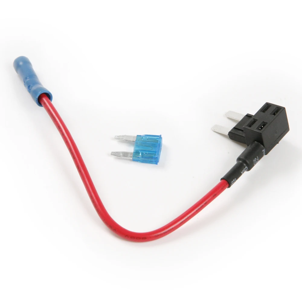

When using one of these fuse taps, does both fuses need to be the same amp?
And does it matter which way the fuse goes in (amp number right side up or upside down?)

Fuses are just metal of certain thickness. Some fuses use different metals that melt slower than others, but they are metals that melt at a lower temperature than the wire connecting them.
the thicker the material, the higher the amount of amps it takes to burn out/melt the metal
https://auto.howstuffworks.com/wfc2.htm
As for which way, fuses of that type are non directional
As for amperage ratings, the fuse that's next to the exiting wire side should be rated for what your accessory needs in order to protect it. The fuse that is inserted at the blade side that goes into the fuse box should be no higher than what the original fuse box location was rated for. In any case, the lowest rated fuse is going to burn out first.... not that the second one will burn out, so the first is the only one, so there isn't a first or second......... know what i'm saiyan, man? hee hee
No, they can be different
The fuse can go in either way, but the tap has to go in the correct way. The end with the wire coming out need to be on the side that doesn't have power with the fuse pulled out of the fusebox. That gives you a totally separate circuit from the one you're tapping into. If you put it the other way around you're adding the load onto the fuse you're tapping into.

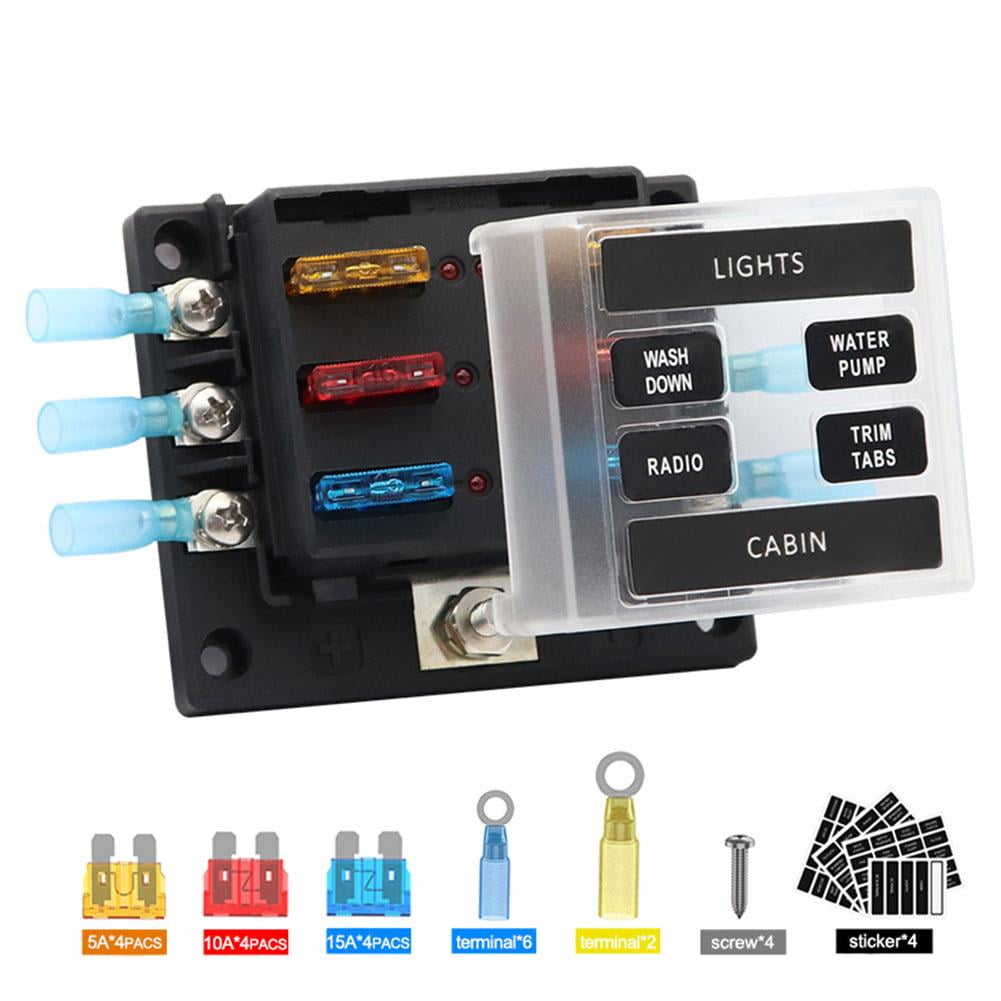

If you're like me and have shitload of accessories, I bypass the factory fuse box and use these.
https://www.grainger.ca/en/product/p...CABEgL4EfD_BwE
Beats having to find ground points each time you add an accessory. I use jumpers designed for the barrier block/strip. Clean and simple. I got mine from SMI Electronics ages ago. Not sure if they carry the stuff anymore. I don't even know if they're still open, for that matter.

Fuses should be replaced with the same rating
larger fuse can result in failed component that its protecting, and a nightmare for the next guy trying to figure out what its protecting
smaller fuse can result in nuisance trips, instant trips, and a nightmare for the next guy trying to figure out why its not working.
It all comes down to what are you protecting, and how you want it protected
Does the top (new/extra fuse) just have to be the same or lower amp than the original and it will be fine? Or it can be completely mix and match?
I don't understand this part.
I understand this one.
Don't understand this one... with the "IN" and "OUT"
It can be completely mix and match.
Is this diagram basically saying the same thing as the one above?
Those diagrams are saying the same thing I was. 12V needs to be supplied on the correct side, otherwise the new circuit and the old one are both pulling through the original fuse, which you don't want. Like this:
See how the power for the new circuit would have to go through both fuses? You don't want that to happen. It will still work, it's just more likely to cause issues with fuses blowing, etc.
Yes.
Positive is on the left side on both diagrams. Upper and lower left sides are joined.
The right sides (the outputs) are independent.
Top one with the pigtail is the accessory you want to add.
If you delete the bottom fuse, your original accessory will no longer work, but the top one will still work. As long as there is a fuse inserted to complete the circuit.
Think of DC (direct current) electricity as if it was water flowing through your house. Water enters from the left. The fuses are like taps. No fuse, the water stops flowing. If the bottom tap is turned off (no fuse or broken fuse), no water flows through your basement faucet. Water will still flow to the upstairs faucet. Take that fuse off and no water flows through your upstairs faucet.
