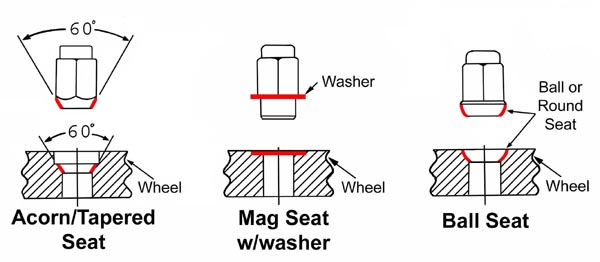

i think you'd find it VERY tough to find the correct thread pitch shank wheel nuts to fit toyota rims onto a subaru...
subaru 12x1.25
toyota 12x1.5
the subaru wheel nuts DO NOT hold toyota wheels on safely...
subaru 12x1.25
toyota 12x1.5
Lol what?
Obviously he will buy proper lug nuts. The wheel doesn't matter. In fact, you can't even screw in a 1.25 into a 1.5...

i'm just sayin' he'll prolly have problems finding the proper lug nut... toyota uses flat mounting (shank) for their alloy wheels... most wheel nuts out there are a 60 degree taper (acorn) or a ball seat (honda style)...
it is incredibly unsafe to run acorn nuts to hold a shank mount wheel onto a car... the hole deforms and you run the risk of the wheel coming loose and falling off...

Thanks for the concerns; That's why I love rs. Pulling up google, narfy is referring to this http://www.delica.ca/forum/download/file.php?id=14794
Thanks coz I honestly did not think of this because I've only swapped rims relating to toyota (gt/gts/aftermarket rims).
I assume if we use the same factory scion lugnuts and they hold the gts rims, then problem solved. Otherwise I'll scavenge around for some proper lugnuts (acorn/ball seat)

no... your FRS is equipped with subaru lug nuts... 12x1.25 thread pitch... toyota shank with washer nuts are 12x1.5 thread pitch and i don't think you'll find nuts that fit your celica wheels in a 12x1.25 thread pitch...
nissan nuts MIGHT fit... i believe they are 12x1.25 shank as well, but i'm not 100% sure...
