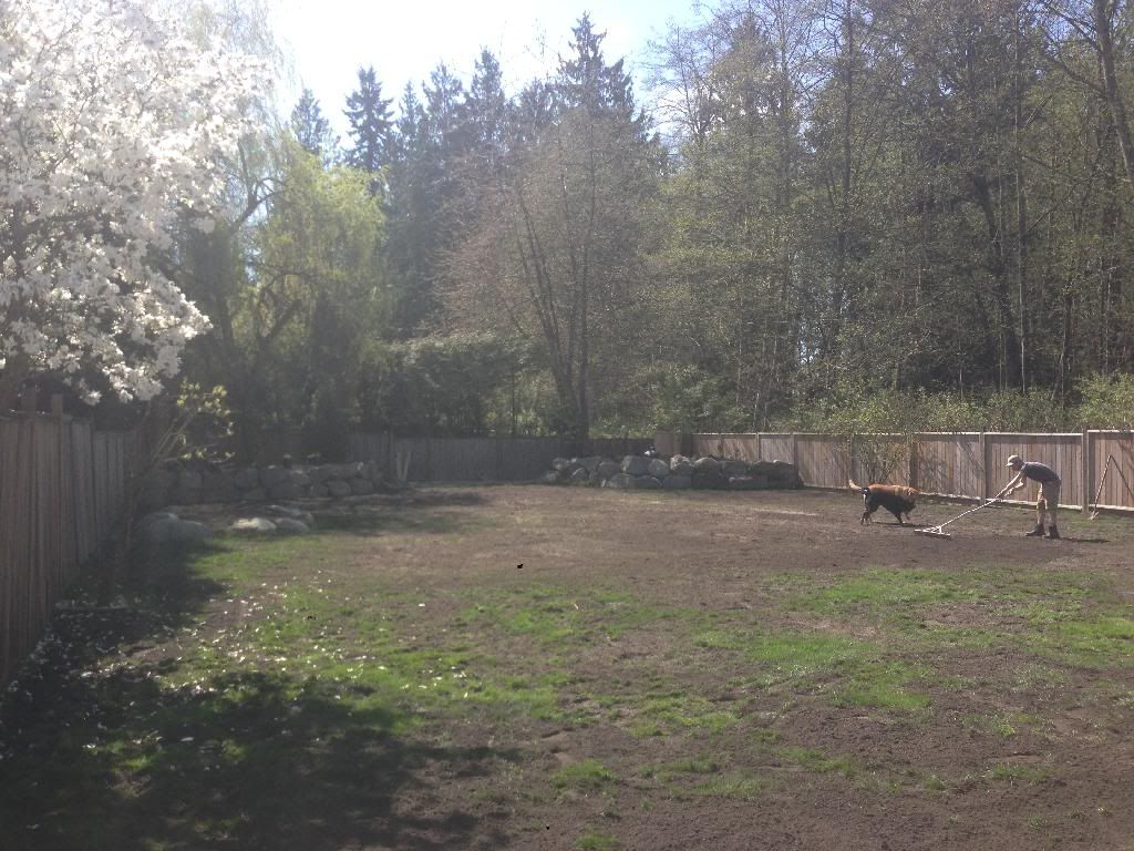

Hondaracer 04-13-2014 05:31 PM
we did a tonne of landscaping last year essentially levelling out a 100 foot by 60 foot back yard, the lowest corner was brought up about 2 feet. We then had it hydroseeded as i mentioned earlier but our dumb dogs basically made the yard look like a mine field over the winter months, and as grass was starting to come back in the last few weeks we saw many patchy areas and holes were grassless so we got a dump truck load of top soil sand mix, it's a 50/50 mix so it's relatively firm
http://i4.photobucket.com/albums/y13...3.jpg~original
down the center and towards the back left corner we also added a drain tile branch that picks up the back end of the yard and down the middle draining off the property to the right side
while it may seem intimidating i think the best thing to do for a lawn is to level it out properly and have it shaped as such that water doesnt pool. From the left side of our yard to the right there is about a 10" slope, 10" over 60 feet is nothing but provides enough in our case
if you guys need any soil i'd highly recommend "Super Soil" in cloverdale, they are super cheap and have very good product. We dont live too too far from them and it was under $200 for a dump truck of this mix delivered right to our house. 3 people can wheelbarrow a dump truck load of soil in about 3-4 hours
So we top dressed, fertilized, then seeded and watered on saturday. I would expect to see growth from the new seed within the month as we bought seed from the company who did the hydro seeding for us, their seed is supposedly coated and retains moisture which encourages growth
