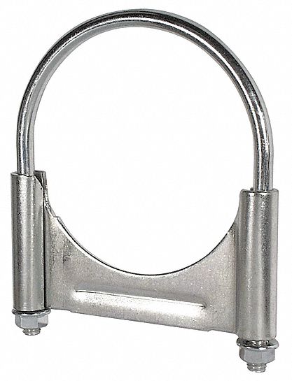

How do I properly clamp together exhaust pieces that are slightly different sizes? The piping is 2.5" and I bought a 2.5" resonator but it's a decent bit bigger than the piping (with the resonator ends going over the piping). A 2.5" clamp is too small, a 2.75" fits and pinches down the top and bottom but the sides have gaps.
I'm using this type of clamp, I'm guessing they're the worst ones to use but I didn't want to order anything online and risk it not fitting.

Impreza 06-02-2019 04:45 PM
https://static.grainger.com/rp/s/is/..._AS01?$mdmain$
Have you tried the flat band exhaust clamps?
Go to a muffler shop and have them expand a piece of tubing to fit on the outside of your piping and inside the resonator, then clamp it down. Sort of like an adapter insert.
I used to have a pipe expander that I used just for that. I'll have a look around to see if I still have it. You can expand the pipe to fit the resonator and then use a clamp. The only problem with band clamps is that they don't distort the metal to hold the pieces together.

underscore 06-02-2019 08:29 PM
I'm in Kelowna so I'll call CT in the morning and see if they have an expander. If that doesn't work instead of modifying piping to fit in the gap is there a reason I couldn't cut a strip of stainless sheet metal to wrap in between? It'd need to be carefully made to just the right length but I've got a bunch sitting here already.
It's not a huge gap but you can see in the picture I've been able to squish two sides in but there's still a gap the other way. I can jam the 2.5" clamp on the "skinny" way but it still spreads the ends too far apart to get the nut end on.
https://i.imgur.com/WxchHI9.jpg
sleepywheel 06-02-2019 09:34 PM
When I was doing the exhaust on my truck, any little opening would create a whistling noise. Just drove me crazy. The clamp should completely encircle the pipe with contact all the way around the outside. Maybe expand the pipe to fit the resonator and then slop some muffler cement inside the connection before installing the clamp.
It looks like the clamp in the picture is the correct size.
I’d do that before filling the gaps with muffler cement. But the more seals you have to make, the more chances of eventual leaks. If all else fails, use a combination of sheet metal and muffler cement! There is also band style clamps which look pretty cool. They don’t distort the pipes like what your using. Can get them in a configurations of overlap like you have or butted together.
